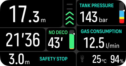

You can follow your actual gas pressure during your dive from the switch window on the device screen. You can also see the average gas consumption from the dive in the dive summary in the device and in Suunto app.
gas consumption-2
The Gas consumption data on the screen refers to your real-time consumption rate of gas during a dive at the depth you are at. To calculate your personal breathing rate, Suunto Nautic uses respiratory minute volume (RMV) which is the volume of gas your lungs experience per minute, measured in L/min or cu ft/min. For accurate gas consumption, you need to define the correct tank size for the gas in the Edit gas menu. See Edit gas. The default tank size is always 12 L (80 cu ft) .
