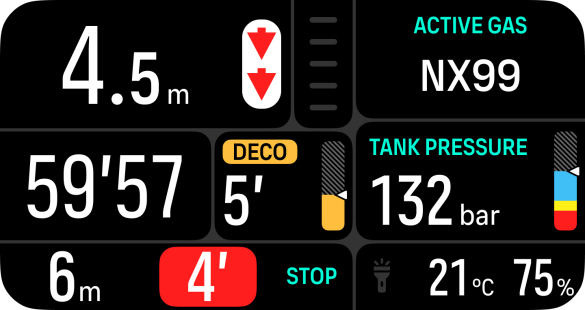

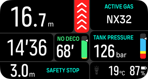

alarm1Ascent speed exceeds safe speed of 10 m (33 ft) per minute for five seconds or more.Stay within the green ascent rate indicators. Monitor for symptoms of DCS. Use extra conservatism for future dives.

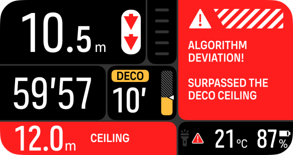

alarm2Decompression ceiling broken by more than 0.6 m (2 ft) on a decompression dive.Descend deeper than the displayed ceiling value.

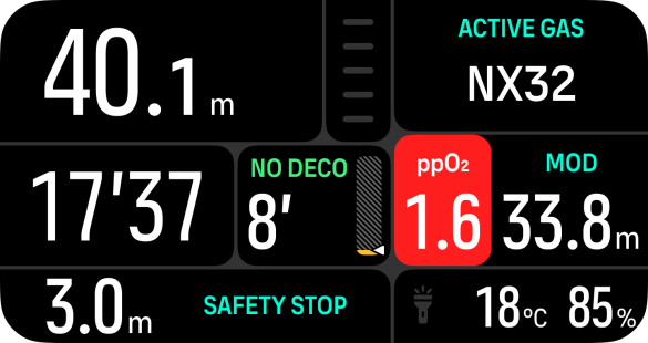

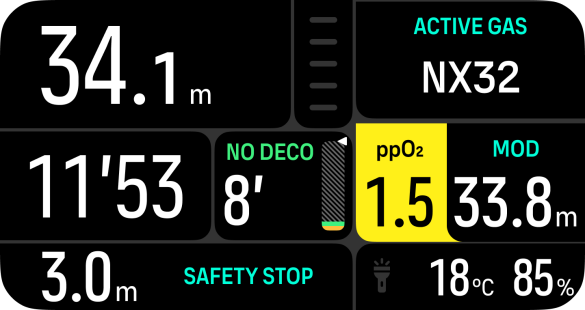

alarm3Partial pressure of oxygen exceeds the maximum level (>1.6).Immediately ascend or change to a gas with lower oxygen percentage.
alarm4Partial pressure of oxygen exceeds the set level for the gas.Immediately ascend or change to a gas with lower oxygen percentage.

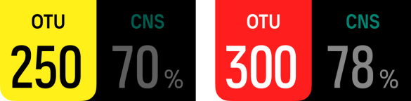

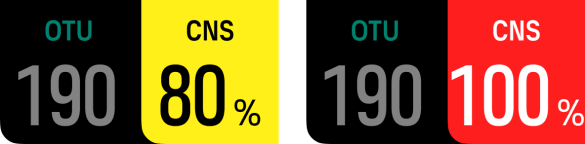

alarm5-1Central Nervous System (CNS) Oxygen Toxicity level at 80% or 100% limit.Switch to a gas with a lower ppO2 or ascend shallower (within decompression ceiling).
alarm680% or 100% of recommended daily limit for OTU reached.Switch to a gas with a lower ppO2 or ascend shallower (within decompression ceiling).

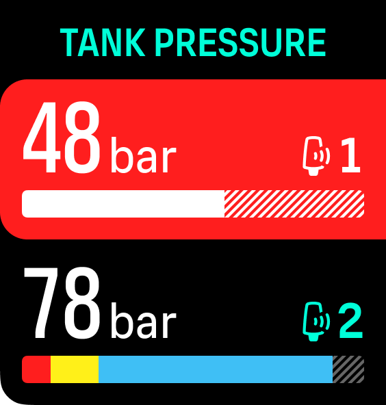

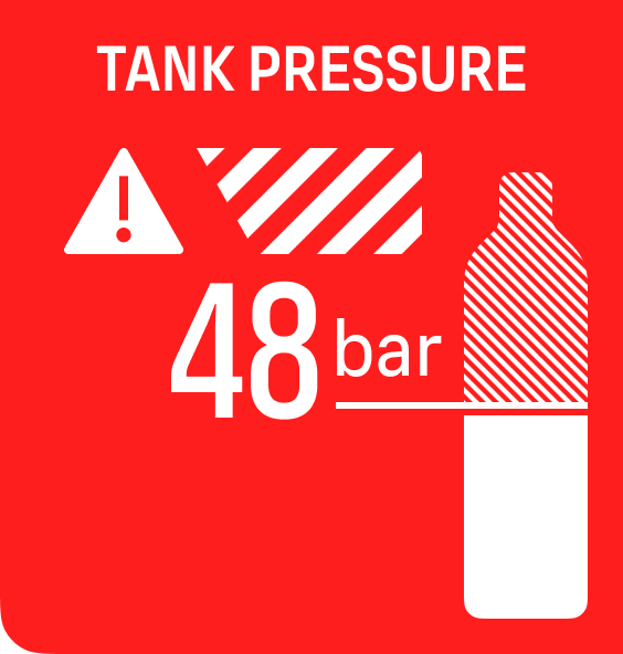

alarm9-1alarm8Tank pressure is below 50 bar (725 psi).Change gas to a higher tank pressure or ascend to safety stop depth and terminate dive.

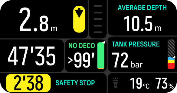

alarm10Not inside the safety stop window.Stay within the safety stop window 3 m – 6 m.

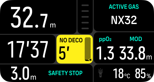

alarm12NDL is less than 5 minutes.Ascend shallower to avoid mandatory decompression stops.
alarm11The decompression ceiling is broken for more than 3 min and your decompression stop is missed.Descend to the ceiling depth indicated in the switch window.
