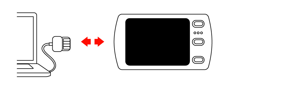

- Wake up the device by connecting the USB cable a to PC/Mac.

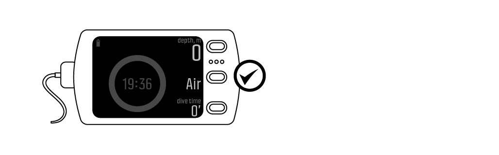

- Follow the startup wizard to set up the device. When ready, the device goes to surface state.
- Fully charge before first dive.
The startup wizard guides you through:
- Language
- Units
- Time format (12h/24h)
- Date format (dd.mm / mm/dd)
- Connecting to Suunto app (recommended)
