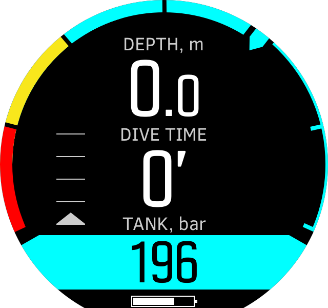

  1. Hold your Suunto Tank POD close to your dive computer in Tank pressure view:
    image-Gas-menu-tankPOD-Eon2

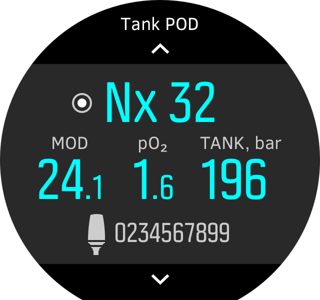

  2. Gases menu opens. Select the gas you want to unpair your Suunto Tank POD from:
    Gas-menu-tankPOD Eon

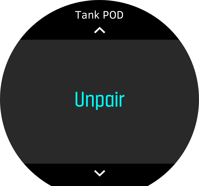

  3. Select Unpair:
    Tankpod unpair Eon

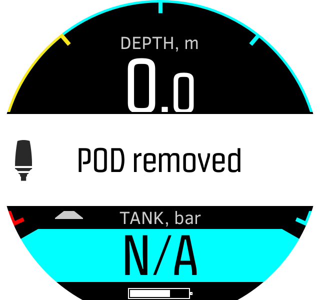

  4. Your Suunto Tank POD is removed from the selected gas list:
    eon menu pairing select gas
    TankPOD-removed Eon

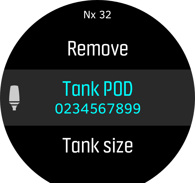

  2. Press the middle button to enter the gas settings and select Tank POD.
    eon menu unpairing assigned pod

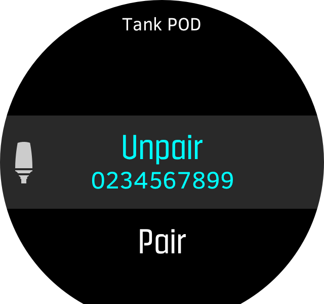

  4. Select Unpair:
    select unpair menu

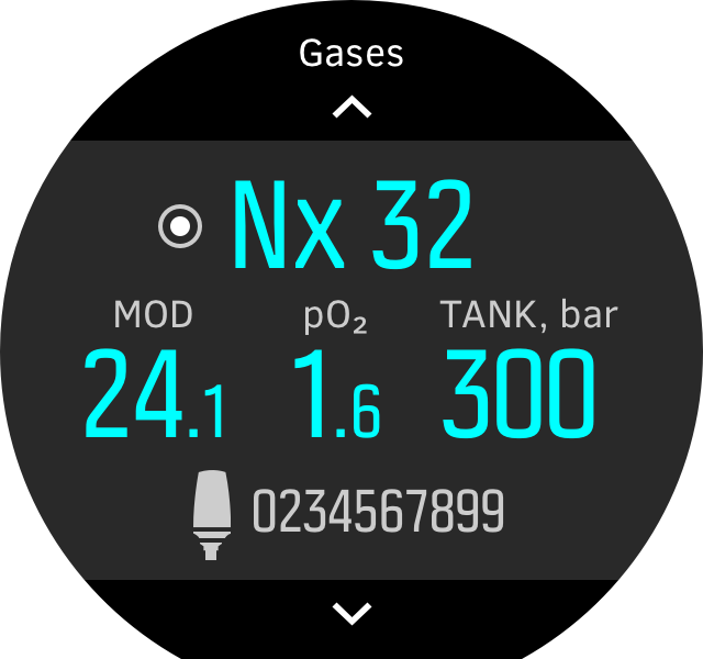

To unpair and remove your Suunto Tank POD from a specific gas using proximity:
    TankPOD-gas-view
    TankPOD-proximity
  3. Press the upper button and select Unpair:
    TankPOD-proximity-unpair
    TankPOD-removed

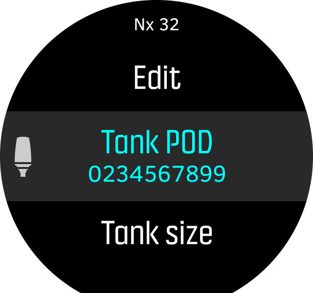

To unpair and remove your Suunto Tank POD from a specific gas through the menu:
  1. Select the gas you want to unpair the Suunto Tank POD from in the Gases menu:
    Gas-menu-tankPOD
    D5 menu unpairing select tankpod menu item
  3. Select the Suunto Tank POD you want to unpair (check the serial number):
    Gas-menu-tankPOD-2
  4. Select Unpair:
    TankPOD-unpair
  5. Your Suunto Tank POD is removed from the selected gas list:
