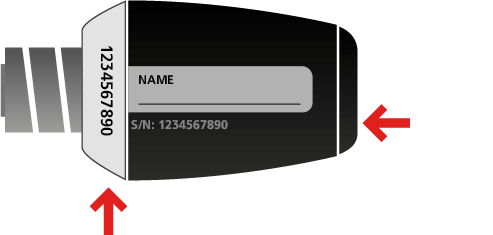

  1. Write down the serial number. You will need it later to identify your Suunto Tank POD. You can find it on the metal base of the device.
    tank pod serial number new
    NOTE:
    Starting May 2021, all new Suunto Tank POD devices have the serial number on the metal base and on the cover, too.

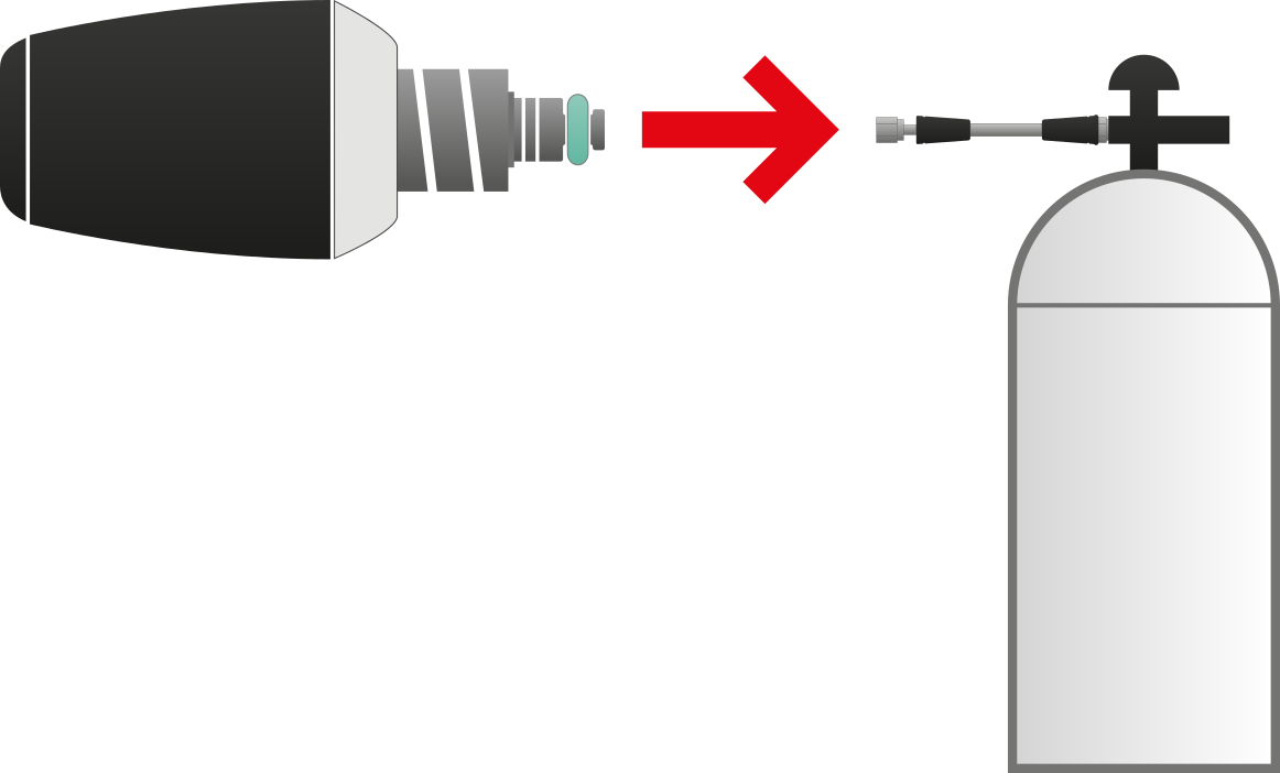

  2. Insert the smooth end of Type B flow restrictor into the Suunto Tank POD. The grooved end should remain visible.
    2 typeB TankPOD

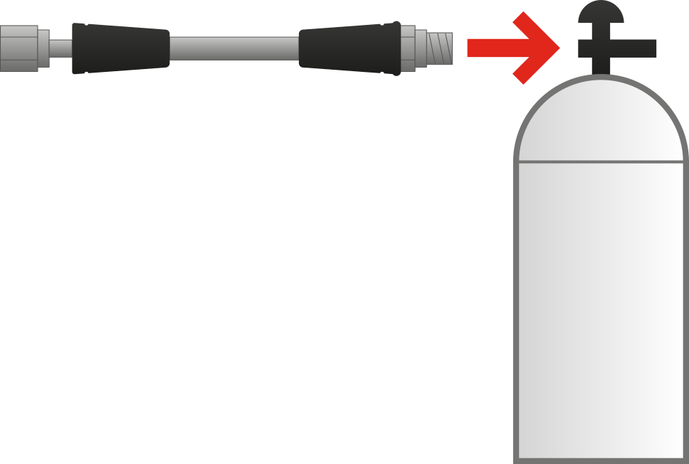

  3. Attach the high pressure hose extension to the first-stage high pressure port.
    3 typeB TankPOD

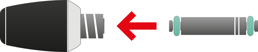

  1. Attach the Suunto Tank POD to the end of the high pressure hose extension, ensuring the grooved end of the restrictor is inserted into the hose.
    4 typeB TankPOD

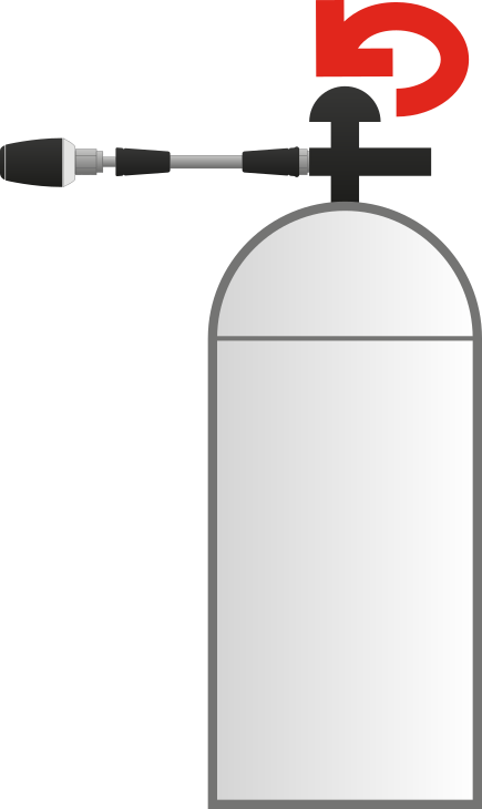

  2. Slowly and steadily open the pressure valve. Look away as your gear is pressurized.
    5 typeB TankPOD
WARNING:
Ensure there are no other people in close proximity when you pressurize scuba gear.
