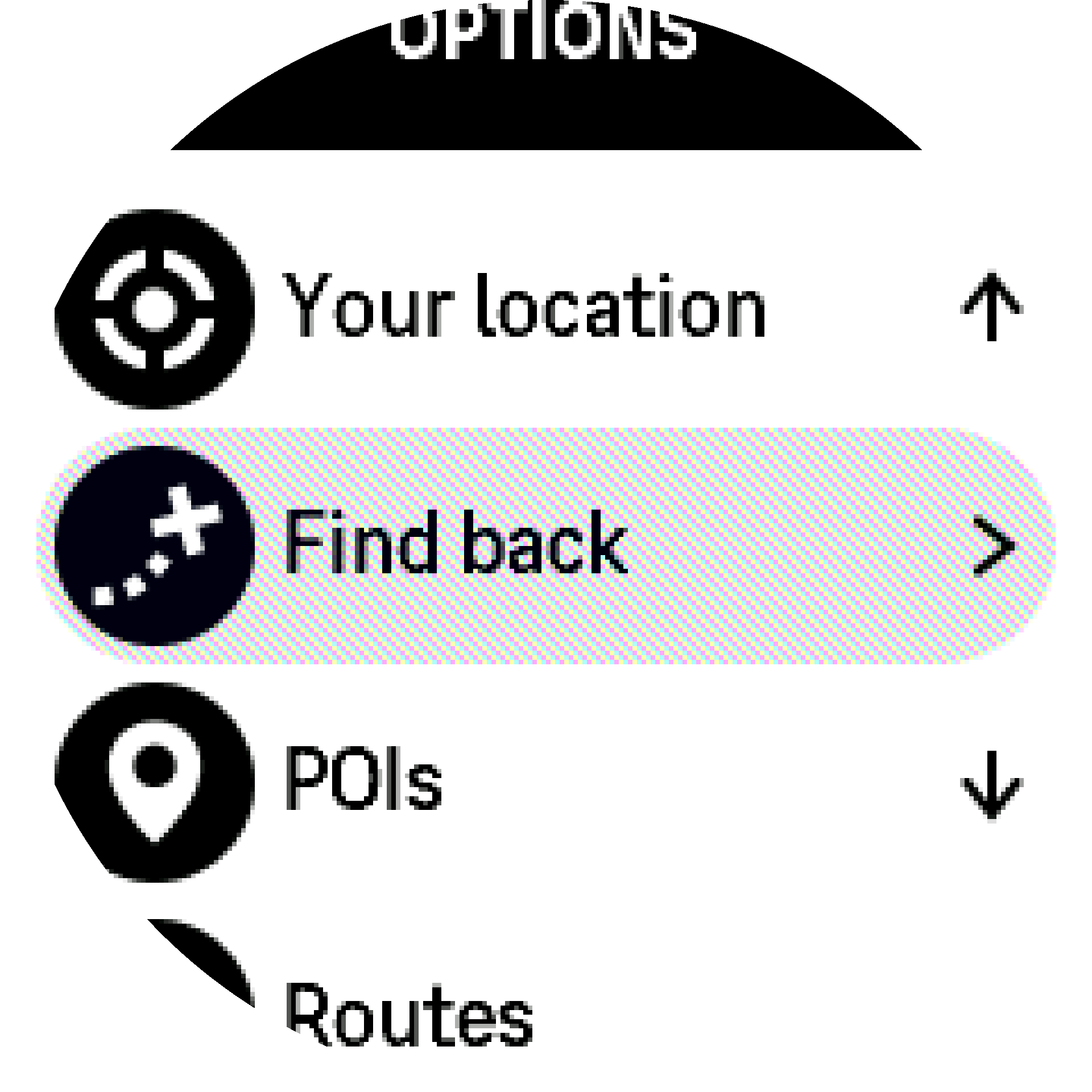

Find back
If you are using GPS when recording an activity, Suunto 9 Peak Pro automatically saves the starting point of your exercise. With Find back, Suunto 9 Peak Pro can guide you directly back to your starting point.
To start Find back:
  1. Start an exercise with GPS.
  2. Press the middle button until you reach the navigation display.
  3. Press the lower button to open the shortcut menu.
  4. Scroll to Find back and tap the screen or press the middle button to select.
    Scroll to Findback S9PP
The navigation guidance is shown as the last display on the selected sport mode.
