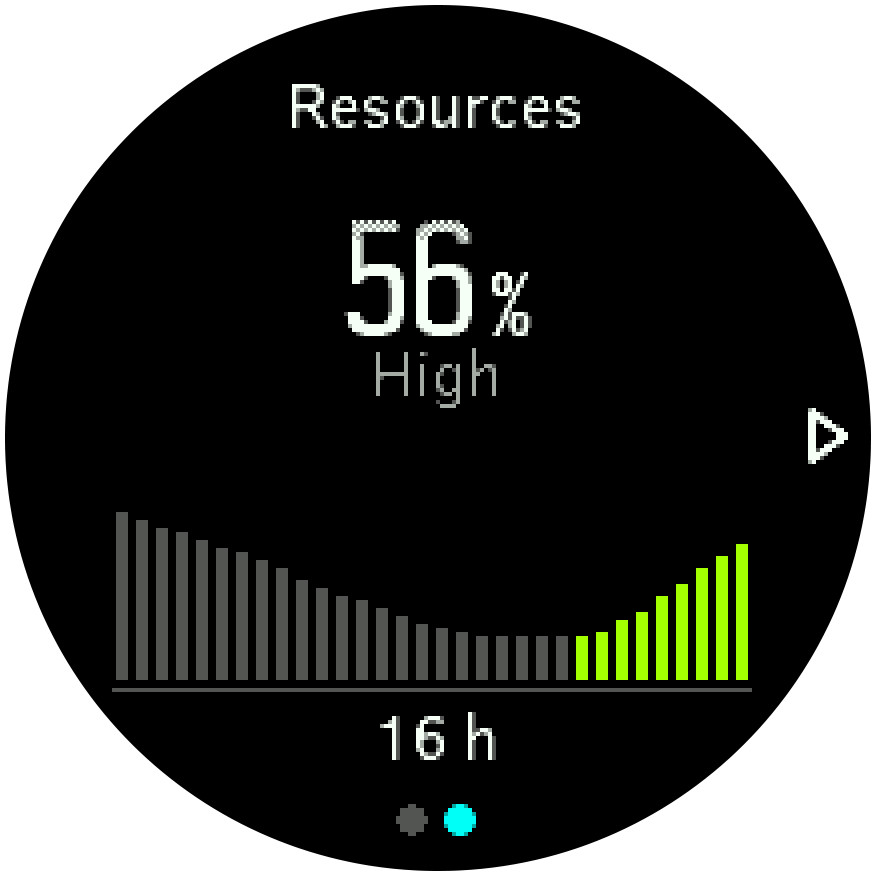

Press the middle button to see a bar chart of your resources over the last 16 hours.
SF3 Resources Graph
The green bars indicate periods where you have been recovering. The percentage value is an estimate of your current resource level.
