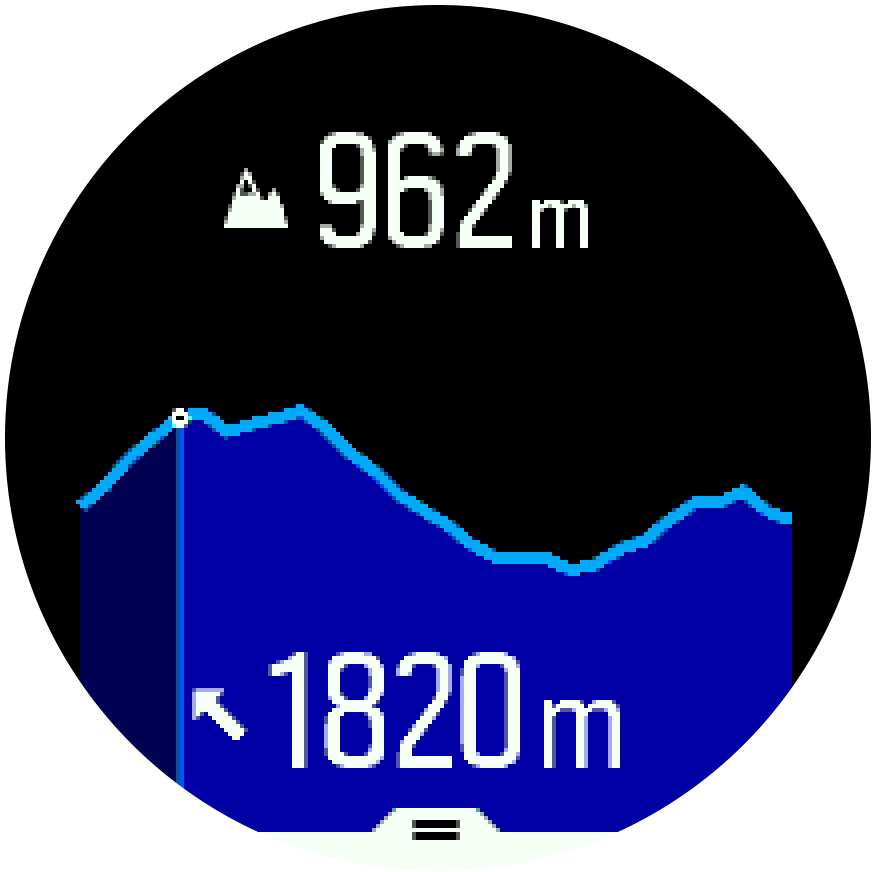

If you are navigating a route that has altitude information, you can also navigate based on ascent and descent using the altitude profile display. While in the main navigation display (where you see your route), press the middle button to switch to the altitude profile display.
The altitude profile display shows you the following information:
  • top: your current altitude
  • center: altitude profile showing your current position
  • bottom: remaining ascent or descent (press the upper left button to change views)
Altitude navigation Trainer
If you stray too far off from the route while using altitude navigation, your watch will give you an Off route message in the altitude profile display. If you see this message, scroll to the route navigation display to get back on track before continuing with altitude navigation.

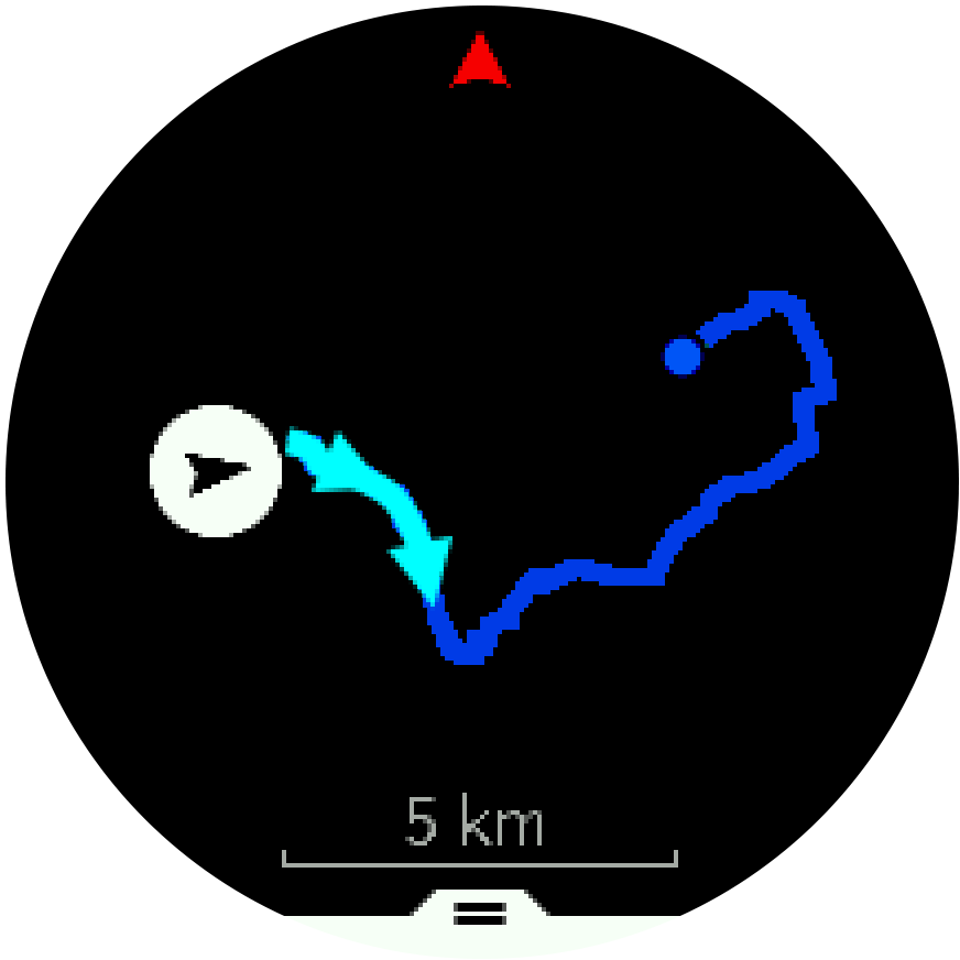

    Route overview S5
In the detailed view, zoom in and out by keeping the middle button pressed. Adjust the zoom level with the upper right and lower right buttons.
NavigationRoute S5

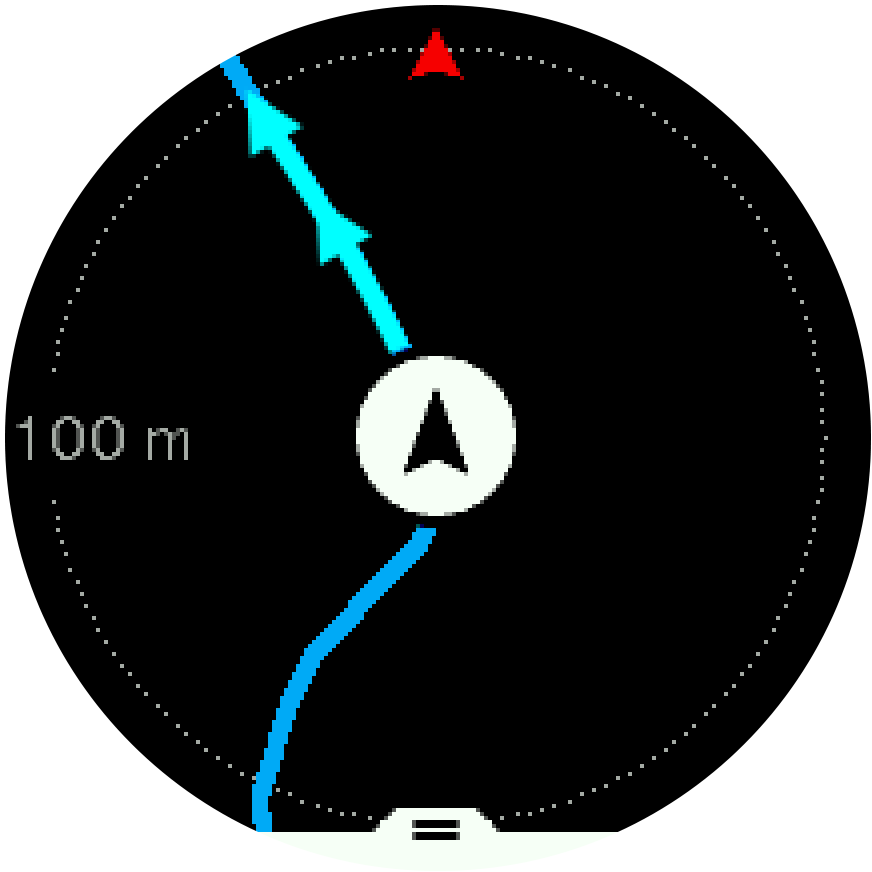

Navigation guidance
As you navigate a route, your watch helps you stay on the correct path by giving you additional notifications as you progress along the route.
For example, if you go more than 100 m (330 ft) off route, the watch notifies you that you are not on the right track, as well as lets you know when you are back on route.

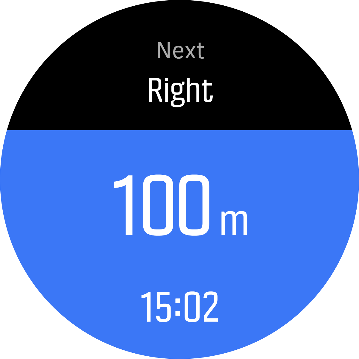

Turn-by-turn navigation
When creating routes in Suunto app, you can choose to activate turn-by-turn instructions. When the route is transferred to your watch and used for navigation, it will give you turn-by-turn instructions with a sound alert and information on which way to turn.

Turn-by-turn navigation powered by Komoot
If you are a Komoot member, you can find or plan routes with Komoot and sync these to your Suunto 5 via Suunto app. In addition, your exercises recorded with your watch will automatically be synchronized to Komoot.
When using route navigation with your Suunto 5 together with routes from Komoot, your watch will give you turn-by-turn instructions with a sound alert and a text on which way to turn.

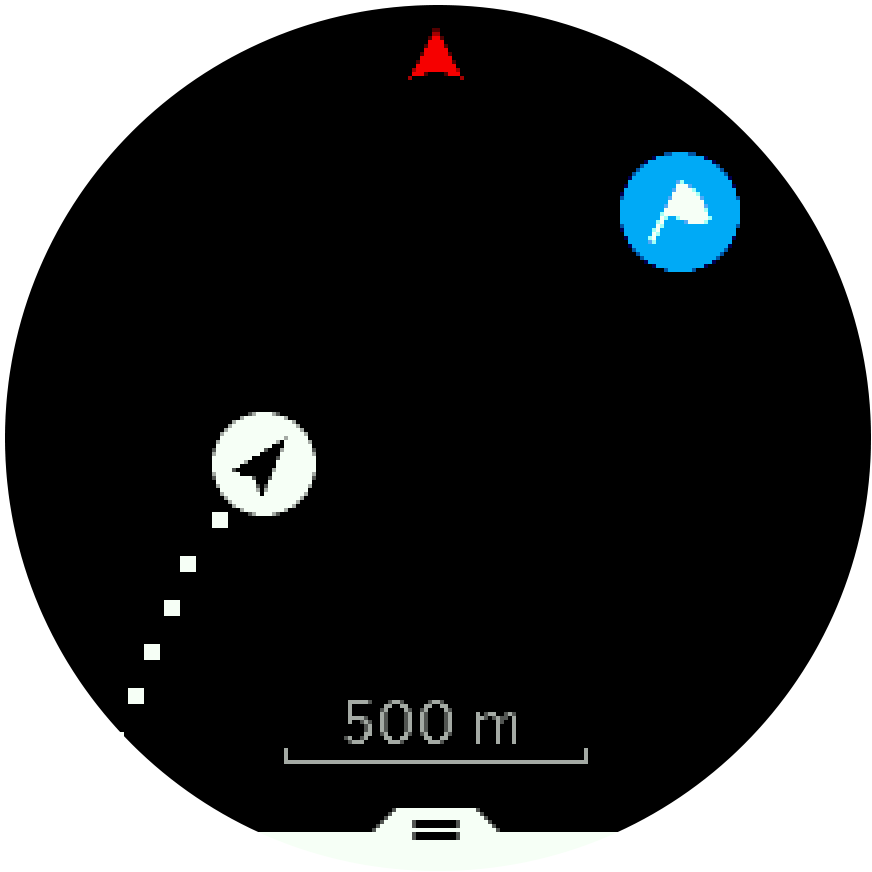

While you are moving, the POI navigation has two views:
  • POI view with direction indicator and distance to the POI
    POI detail view Trainer
  • map view showing your current location relative to the POI and your breadcrumb trail (the track you have traveled)
    POI map view Trainer
Press the middle button to switch between views. If you stop moving, the watch cannot determine which direction you are going based on GPS.
